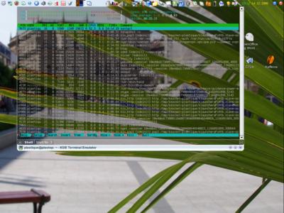

By using Yakuake, this wouldn’t be an issue anymore. I add it to my autostart applications. So instead of start a terminal and switch it every time and minimise after using it, I just press a hotkey (I set it to Alt+X as it is very handy for my left hand), a console will slide from my top screen edge, then I can type and command I want, or add more tabs. To inactivate it, just click outside this console it will slide back as nothing happens, or press the hotkey again. This applies to all my desktops. Besides, the interface is really :thumpsup_green: cool, I set it to use Konsole’s settings, others default. Here is a screenshot:
